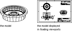

The following illustration shows how different views of a model can be displayed in Paper space. Each Paper space image represents a Viewport object with a different view. In one view, the layer for dimensions is frozen. Notice that the title block, border, and annotation, which are drawn in Paper space, do not appear in the Model space view. Also, the layer containing the viewport borders has been frozen.
