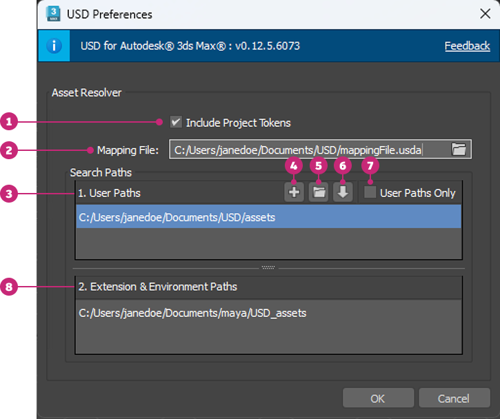

To access the USD Asset Resolver Settings dialog, go to USD > USD Preferences.
This dialog lets you manage how USD resolves asset paths in 3ds Max. It defines where and how the resolver searches for assets, including project tokens, user-defined paths, and environment variables.
  1. Include Project Tokens: Enables this option to let the USD Asset Resolver use the paths set in 3ds Max’s Configure Project Paths dialog as search tokens.
  2. Mapping File: Specifies a mapping file that contains data used by the resolver, such as search paths and tokens. Use the Browse button to navigate and select the file. You can also create custom mapping files to match your specific environment setup.
Example of a USD mapping file:
   #usda 1.0
        customLayerData = {
            string[] searchPaths = ["E:/Assets/Kitbash3d/Source"]
            string[] tokenMappingPairs = ["assets", "E:/Assets/Kitbash3d/Source/library/assets"]
            string[] pathMappingPairs = ["assetA/assetA.usd", "assetA/assetA_v002.usd"]
            string[] regexMappingPairs= ["\b[a-z]{4}\b", "path"]
Note:
Use searchPaths and tokenMappingPairs for standard workflows. The other methods (pathMappingPairs and regexMappingPairs) are experimental.
  1. User Paths: Define your own custom search paths for the Asset Resolver.
  1. Add: Click the + button to add a new blank row where you can enter a custom search path.
  2. Add via Browse: Opens a file browser to select a directory and add it to the list. If multiple paths are selected, the Browse button is disabled.
  3. Move Up/Move Down: Reorder user-defined paths to control their search priority relative to extension and environment variable paths.
Important:
The order of search paths affects performance. Place paths that are used most often at the top of the list for faster resolution. Avoid using broad or root-level paths (for example, C:), as they can significantly slow down searches.
  1. User Paths Only: Enable this option to restrict the resolver to search only within user-defined paths. When checked, paths from extensions and environment variables are ignored.
  2. Extensions & Environment Variables Paths: Lists paths added automatically through the mapping file or environment variables. These entries are read-only and cannot be reordered, but you can copy them for reference. The Asset Resolver automatically gathers search paths from the following environment variables:
    • ADSK_AR_SEARCH_PATH
    • PXR_AR_DEFAULT_SEARCH_PATH
    • ADSK_AR_MAPPING_FILE
      ADSK_AR_SEARCH_PATH and PXR_AR_DEFAULT_SEARCH_PATH define search paths used to resolve relative asset references. ADSK_AR_MAPPING_FILE points to a system-wide default mapping file that can include both tokens and search paths. On Windows, these variables use semicolon-separated path strings.
Note:
Changes made in the Asset Resolver Settings do not affect USD stages already loaded in the current scene. To apply the updated settings, start a new scene or session.
