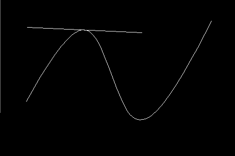

Assume that splineObj points to the spline in the following drawing:
Sample curve (spline) for vlax-curve-getDistAtParam

Determine the distance to the parameter midway along the curve:
(vlax-curve-getDistAtParam splineObj
   ( / (- endspline startspline) 2))
8.99417
The distance from the start to the middle of the curve is 8.99417.
