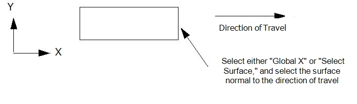

Either key in a vector or use the pop-out to set the direction of travel of the object.
Choose the Global X, Y, or Z axes to choose a Cartesian direction as the motion direction.
To graphically set the direction, click the Select Surface button, and select a surface. The motion direction will be normal to the selected surface.
Click the Inverse button to switch the direction.
An example of assigning linear direction:
