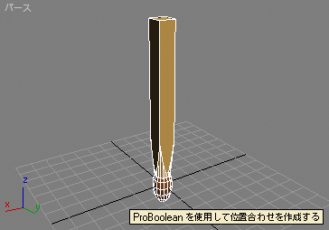

--Creating a match using two consecutive boolean operations between --a box, a cone and a sphere: theBox = box height:100 width:10 length:10--create a box theCone = cone radius1:4 radius2:15 height:110--create a cone theSphere = sphere radius:6--create a sphere xf = xform()--create an XForm modifier addModifier theSphere xf--add the XForm to the sphere xf.gizmo.scale = [1,1,2]--scale the sphere along Z --create an intersection of the box as operand A and the cone as operand B: ProBoolean.createBooleanObject theBox theCone 1 0 0 --assign materials to the box and to the sphere: theBox.material = standard diffuse:(color 255 200 100) theSphere.material = standard diffuse:brown ProBoolean.SetBoolOp theBox 0--set the boolean operation to union ProBoolean.setOperandB theBox theSphere 0 0--add the sphere asnewoperand B

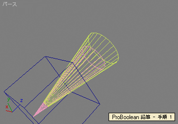

--Creating a Pencil using multiple boolean subtractions --of a box, two cones and a cylinder: --Step 1: create a box and two cones, assign materials: theBox = box height:50 width:50 length:50 pos:[0,0,-2] theCone1 = cone radius1:3 radius2:20 height:80 heightsegs:1 pos:[0,0,15] theCone2 = cone radius1:0 radius2:15 height:80 heightsegs:1 theCone1.material = standard diffuse:(color 255 220 200) theCone2.material = standard diffuse:black

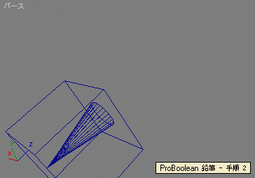

--Step 2: Subtract both cones from the box ProBoolean.createBooleanObjects theBox #(theCone2,theCone1) 2 0 0

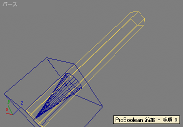

--Step 3: Create a 6-sided cylinder and assign a material theCyl = cylinder radius:10 sides:6 height:150 smooth:false pos:[0,0,1] theCyl.material = standard diffuse:(color 255 200 100)

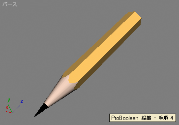

--Step 4: "sharpen" the cylinder using the box with the conical hole ProBoolean.createBooleanObject theCyl theBox 2 0 0
