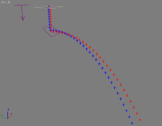

使用例:
( resetMaxFile #noPrompt gravity pos:[41.7827,242.9,0] isSelected:on iconSize:33.4742 transform:(matrix3 [1,0,0] [0,-1,0] [0,0,-1] [41.7827,242.9,0]) Deflector bounce:1 width:101.617 length:74.9636 transform:(matrix3 [1,0,0] [0,0.751713,0.659491] [0,-0.659491,0.751713] [16.7722,4.28949,-146.329]) posArray=#([10,0,0],[10,10,0]) velArray=#([0,0,0],[0,0,0]) forceArray=#([0,0,0],[0,0,0]) for i = 0 to 40 do( point pos:posArray[1] wirecolor:red point pos:posArray[2] wirecolor:blue at time i WSMApplyFC #($gravity001,$deflector001) posArray velArray forceArray ) )
