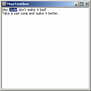

この dotNetObject は MaxCustomControls アセンブリにより実装され、DotNet TextBox コントロールに 3ds Max の見た目と操作感をもたらします。
例:
theFrm = dotNetObject "MaxCustomControls.MaxForm" theBox = dotNetObject "MaxCustomControls.MaxTextBox" theBox.width = 290 theBox.height = 270 theBox.Multiline = true theBox.Text = "Hey Jude, don't make it bad!\r\nTake a sad song and make it better..." theBox.SelectionStart = 4 theBox.SelectionLength = 4 theFrm.controls.add theBox theFrm.topmost = true theFrm.text = "MaxTextBox" thePtr = DotNetObject "System.IntPtr" (windows.getMAXHWND()) theHwnd = (dotNetObject "System.Windows.Forms.NativeWindow").FromHandle thePtr theFrm.Show(theHwnd)
