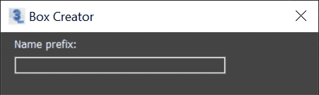

例:
rollout boxCreator "Box Creator" ( --define an edittextwith width 100 and the label on top: edittext prefix_txt "Name prefix:" fieldWidth:200 labelOnTop:true --If the user entered a new name... on prefix_txt entered txt do ( --And the name is not the empty string, if txt != "" do ( --Create a new box at a random position --somewhere between the given coordinates: new_obj = box pos:(random [-100,-100,-100] [100,100,100]) --Set the name of the new object to the prefix entered, --but add unique suffix to avoid duplicate names: new_obj.name = (uniquename txt) --And finally clear the edittext for a new entry --by assigning an empty string to the text property: prefix_txt.text = "" ) ) ) createDialog boxCreator 300 60 --create a Dialog from the rollout
