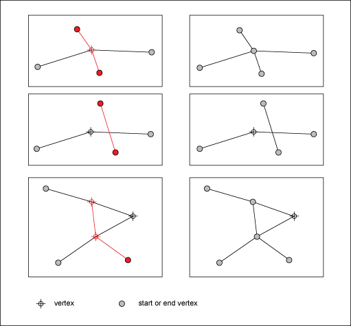

The AutomaticLineSplitAtVertex feature rule splits a line at a vertex when you use this vertex to digitize a new line. For example, when you digitize topology edges.
Name |
AutomaticLineSplit_BIU |
Classification |
System feature rule. |
Location |
Assembly: Autodesk.Map.IM.BaseFeatureRules.dll Classname: Autodesk.Map.IM.BaseFeatureRules.LineLengthRules |
Type |
Client-side Before Insert (BI); Before Update (BU). Is System. Is Row. |
Description |
Splits a line at a vertex when you use this vertex to digitize a new line. |
