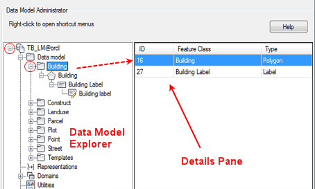

Data Model Administrator provides tools to do the following:
A data model includes topics, domains, feature classes, topologies, and intersections. You use the Data Model Administrator to explore the data structures of an industry model.
Data Model Administrator with Data Model Explorer
