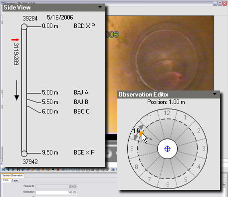

Wastewater networks require regular inspections to avoid sanitation and flood damage. Accurate inspection data is important for judging the severity of necessary repairs and estimating renovation costs. You can import inspection data and do the following:
To simplify the review of inspection data, the Inspection Editor displays a side-view representation of the inspected section of pipe along with damage codes at specific distances along the length of the section. An Observation Editor displays a graphical representation of the inside of the inspected section.
