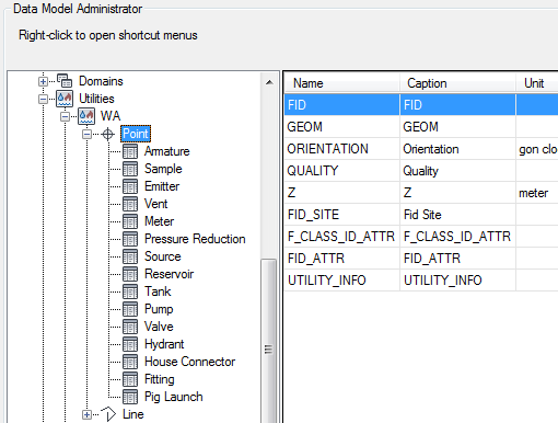

Example: In the Water application, the utility node feature class has a multi-relation to all point attribute feature classes, such as armature, emitter, vents, meters and so on. The utility edge feature class has a relation to the line attribute feature class Pipe.
Utility data model: Water node feature class Point with its relations to the object feature classes; shown in the data model explorer.
