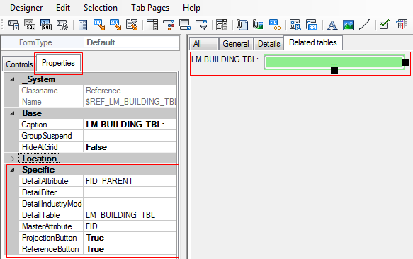

The second type of controls allow access to records related to the current record. These are created for each relation, but you can define additional controls. For example, by default, a reference control is defined for label feature classes.
Form Designer: Reference type controls look like a button and allow accessing related data. Click the control in the right pane and set its properties.
