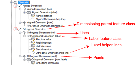

A dimensioning consists of several related feature classes. When you add the Dimension Extension to an industry model, the dimensioning feature classes are created, as shown in the following illustration.
Data Model: A dimensioning feature class consists of several related feature classes.
Dimension Parent: This attribute table does not store any geometry.
Dimension Table |

Dimension Children: These tables store the geometry.
Dimension Point Child |
Description |
<dimension>_P |
Stores the points at the start and endpoints of the measure line, such as abscissas and ordinates. |

Dimension Line Child |
Description |
<dimension>_L |
Stores the measure line. |

Label |
<dimension>_TBL |
The label feature class stores the measure label texts. See also Feature Class Type: Label |
Dimension Label Line |
Description |
<dimension>_HL |
Stores lines that are related to labels, for example lines that point to the feature where the label belongs to. |
