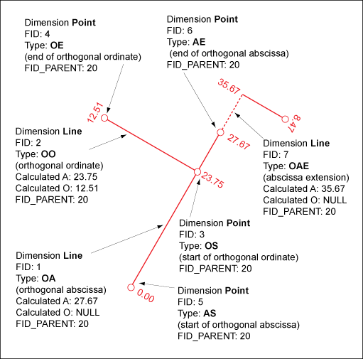

There are several types of orthogonal dimensioning. Depending on the dimensioning type, the system uses the LINE_TYPE attribute and the POINT_TYPE attribute to distinguish the points and lines. In the display models, you use these attributes to stylize the dimensioning layers.
For example, if the abscissa has been extended, because an orthogonal point is located behind the end point of the abscissa, the line is of type OAE, and you can style the line as a dashed line.
Data Model: Components of an orthogonal dimension.
An orthogonal dimensioning consists of points and lines, as shown in the following table.

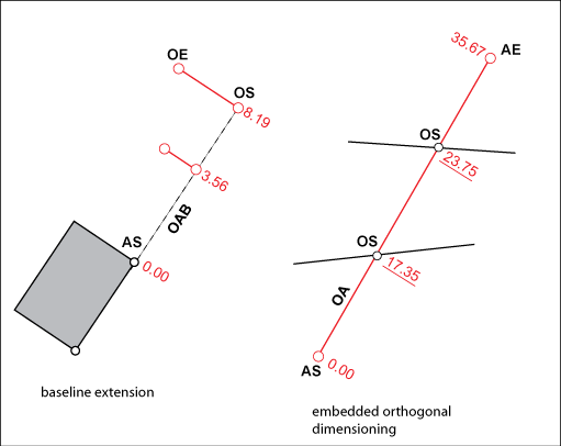

OE = Orthogonal Extension Baseline |
Orthogonal Dimensioning based on the extension of a baseline. For example, you use the edge of a building as abscissa. Consists of:
Both OC and OE dimensioning support embedded feature dimensioning. An embedded feature is a line that intersects the orthogonal abscissa. The intersection point can be embedded as any other orthogonal point.
Components of an orthogonal baseline dimension, and an embedded dimension.
