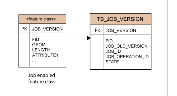

The table TB_JOB_VERSION stores the complete history of every feature. The feature table has one job relevant attribute: JOB_VERSION. The table TB_JOB_VERSION also controls which features are visible.
TB_JOB_VERSION holds the history of every feature and controls which features are visible.
With JOB_VERSION the FID is not unique, however with the Virtual Private Database it is.

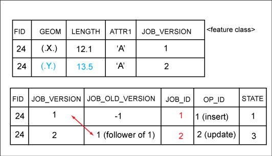

Example: A “SELECT * from <feature class> returns the following values: |
With Job 1: 24, (.X.), 12.1, ‘A’, 1 |
With Job 2: 24, (.Y.), 13.5, ‘A’, 2 |
The JOB_OPERATION_ID shows the operation performed on the feature, for example, Insert, Modify, or Delete.

After a table has been job enabled, a new value for JOB_VERSION is created for every object (sequence TB_JOB_VERSION_S):
If a user works on a feature within a certain job (JOB_ID) and for example modifies a feature, the operation is registered in TB_JOB_VERSION as follows:
You can trace the history of every feature, including the operation performed, the date, user, and initial appearance.
