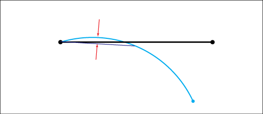

When you create an area topology, you can set the default value for the arc linearize tolerance. You cannot change it later without dropping and recreating the topology.
The arc linearize tolerance helps to overcome data impurity, especially minor overlapping of arc segments. If overlapping is detected, then the arc segment is linearized in the same way that the respective segments, at the beginning or the end of the arc, are replaced by linear segments. If such linearization overcomes the topology error and overlapping disappears, the polygon is stored. Otherwise a topology error is returned.
Area topology: By setting the arc linearization tolerance, you can control overlapping of arcs and lines.
The value for arc linearize tolerance cannot be smaller than the spatial tolerance for the line feature class. It should be 2 – 5 times the spatial tolerance of the line feature class.

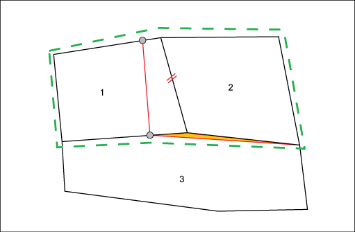

Modifying an edge inside an area feature perimeter affects the corresponding areas located to the left and right of it. If these areas lie outside the perimeter, or within the perimeter buffer, the modification can be cancelled if it is significant.
If the industry model is job enabled, and if the current job has a perimeter assigned, polygons outside the perimeter are checked, to see whether the area is changing more than the specified tolerance. For example, Swiss land management does not allow changes greater than 1m2.
