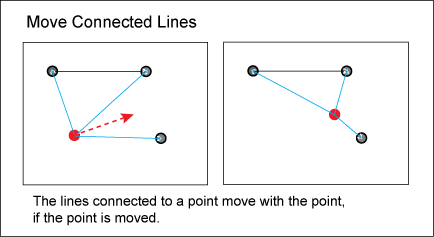

The MoveConnectedLines rule group moves lines connected to a point when the point is moved, such that the line and the point stay connected.
The rule group applies to Utility point feature classes.
