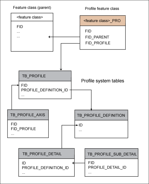

Profile system tables store the configuration of the profiles in the industry model, as shown in the following table. Use the Profile Designer to edit the configuration.
Table |
Description |
TB_PROFILE |
Point feature class that stores the origin of a profile. |
TB_PROFILE_AXIS |
Line string feature class that stores the axis of the profile. |
TB_PROFILE_DEFINITION |
Stores the profile definition. |
TB_PROFILE_DETAIL |
Stores profile details. |
TB_PROFILE_SUB_DETAIL |
Stores profile sub details. |
