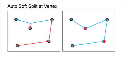

The AutoSoftSplitAtVertex rule group splits a line at a vertex when it is at the same location as a utility point. Depending on user data and use cases, this rule group can optionally be enabled.
The rule group applies to Utility line feature classes.

Looks for utility points at the vertices and soft splits the line if utility points are found. |
