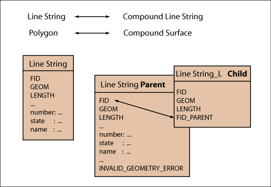

You can convert a line string or polygon feature class into a compound feature class. The existing line string or polygon feature class is the parent feature class and a new child feature class is created. All attributes of the existing parent class are maintained.
Data Model: Converting a feature class to a Compound.
You can convert a compound feature class into a line string or polygon feature class. The parent feature class persists, but the child feature class (single segment) and all subordinate feature classes are dropped.
