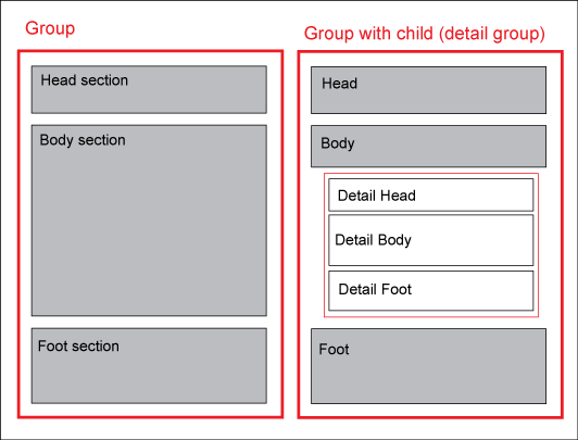

A report layout consists of the following parts:
Report layout showing a group with head, body, and foot sections and a group with a child group
Section |
Description |
Page Group |
Page Head |
The content of this section is repeated on top of every page. |
Page Foot |
The content of this section is repeated at the bottom of every page. |
Detail Group |
Detail Head |
The content of this section is printed only once, above the data in the preceding body section. |
Detail Body |
The content of this section is repeated for every record of the SQL statement that is set in the Group properties. |
Detail Foot |
The content of this section is printed after the records of the body section. |
