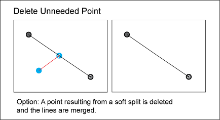

The DeleteUnneededNodes rule group cleans up utility lines. The rule group applies to Utility line feature classes.
After a line is deleted, the rule group deletes points that do not have lines connected to them.

Description |
Deletes start and end nodes if they are no longer needed. |

Description |
Parameters |
P1: DeleteSoftSplitters. Default is NO. Specifies whether the points which resulted from a soft split should be deleted and the lines merged, similar to the AutoExtractSoftSplit feature rule. P2: AskUser. Default is YES. Specifies whether the user is asked if the unneeded points should be deleted. If the parameter is NO, they are deleted without user interaction. |
