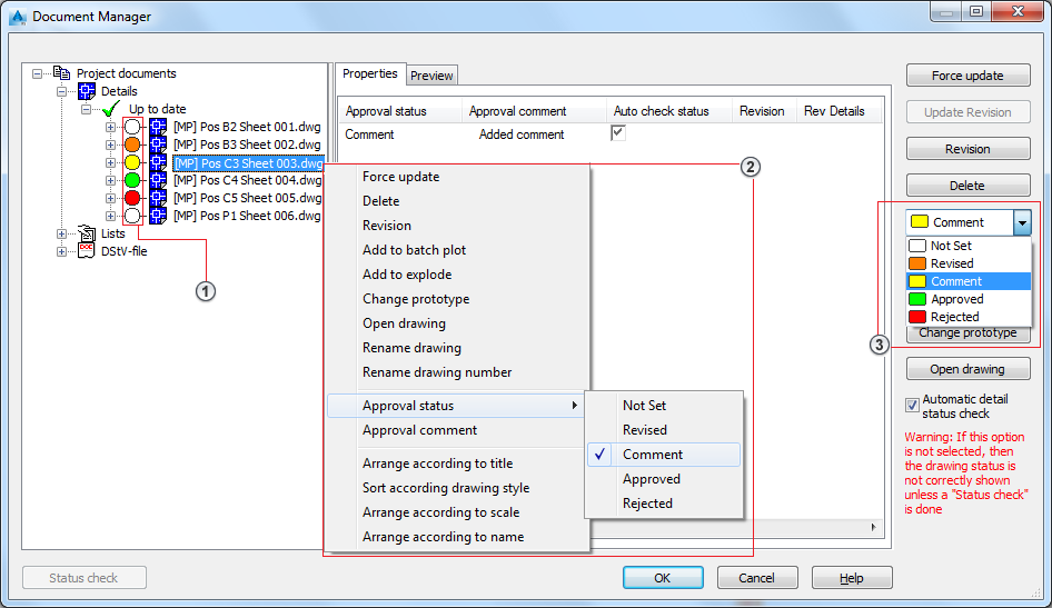

Define the state of a drawing that will be issued to production.
You can set the Drawing Approval Status in three ways:
The Approval comment is a text box where you can enter specifications for revision or for production.
To add a drawing comment, right-click on a selected item and choose Approval comment from the contextual menu.
The drawing approval status and comments are displayed in the Properties tab of the dialog, allowing you to sort the drawing list according to approval status or approval comment.
