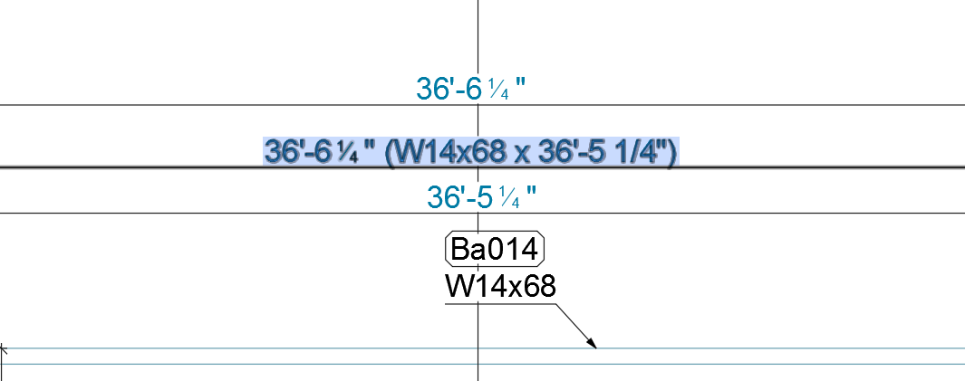

The blank background rectangle appears when highlighting the dimension or label:

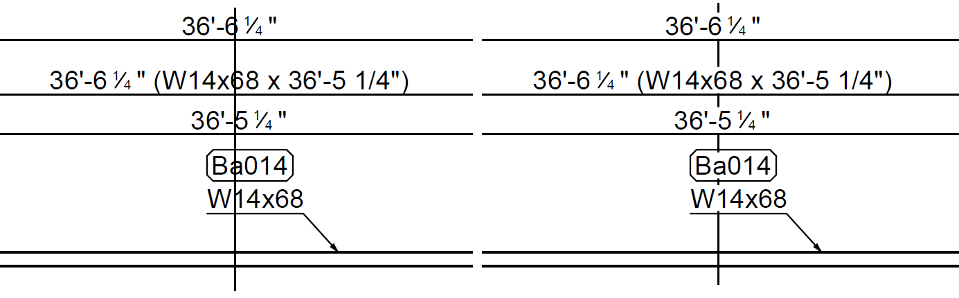

Turning on the blank background feature brings a considerable increase in printing quality and eliminates the need to manually arrange labels and dimensions:

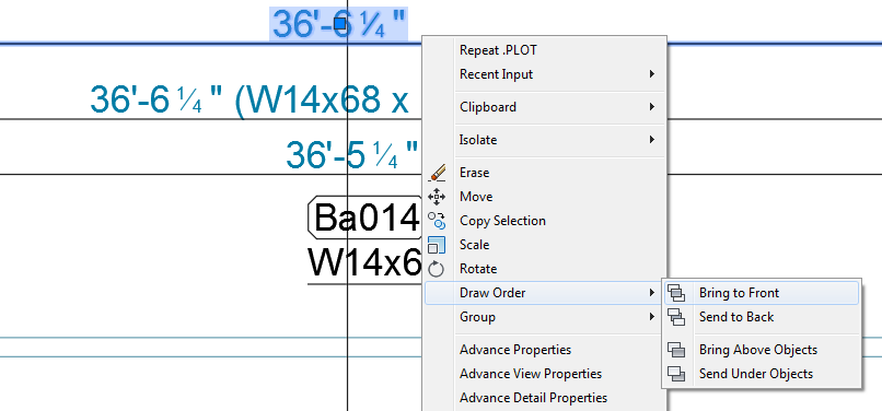

The blank background mechanism applied to the text extends (the rectangle around the text size) is similar to the AutoCAD wipeout mechanism/blank background for MTEXT objects. This mechanism relies on the draw order of the objects that the backgrounds need to hide. The texts using the blank background functionality need to be higher in draw order priority than the other objects, in order to correctly hide graphics for overlapping objects:
On drawings automatically created by Advance Steel, the draw order of labels and dimensions is:

You may need to use the AutoCAD regen command when opening drawings from previous versions and make the necessary dimension style modifications to activate the dimension background. The regen command is also used if the Management Tools default is activated while the drawing is open in a current Advance Steel session. As the coherence of the dimension and label backgrounds depends on the draw order, in some specific cases you may need to manually override the draw order using the AutoCAD Bring to front command to obtain the desired result.
