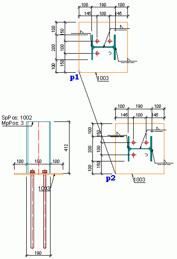

When creating assembly drawings, various views and cuts of the main part may be generated. You can change their position on the created drawing.

Move a view
Parametric Views panel, click
(Move view).
The selected view is moved to a new location, determined by the position relative to the reference point and the distance and direction determined by the two points.
