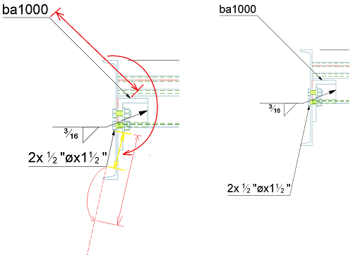

Arrange labels on drawings using an existing reference label and a set of predefined rules.
To access the Arrange labels command:
The command will ask only for the labels to arrange, once used on any label that is used as reference. The command can arrange one or multiple labels, and it will accept multi-selections by clicking the labels or using a blanket selection.
The command will only arrange labels, so any other objects or annotations inside the blanket selection will not be moved.
