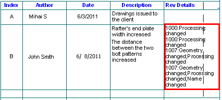

All the prototypes already include revision tables but different ones can be added manually by specifying two diagonal points on a drawing. All the information about the revisions added here are saved in the drawing and will appear in the Document Manager.
| Column | Description |
| Index | A letter or a number identifying the revision level. |
| Author and Date | The name of the author who has worked on the model and the time work was done on the model. |
| Description | The description of all changes made during a revision level. |
| Rev Details | Some revision tables may contain the Rev Details column. Advance Steel will automatically complete this column with a generic description of the changes on the drawing. |
