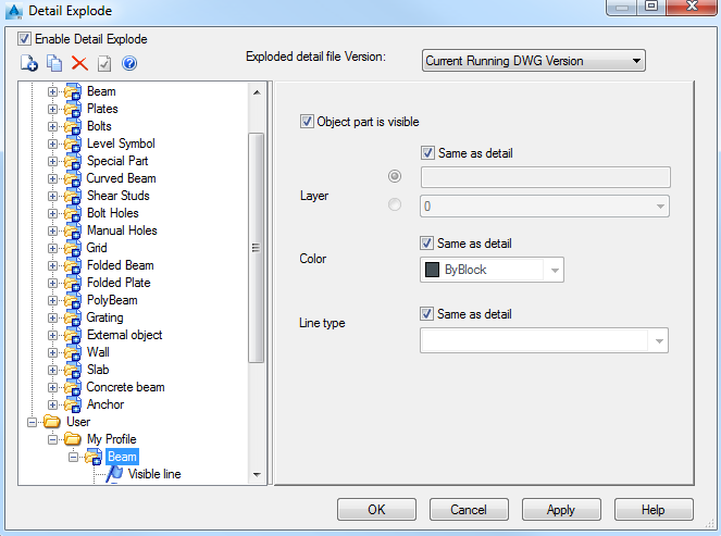

learn about the different options and settings you can configure in the Detail Explode dialog.
Enables the Detail Explode Settings. While exploding the details, for each object or sub-object, a corresponding setting will be searched in the Current Profile. If there is no setting, the explode settings will be used from Advance Steel category.
Exploded detail file Version.
Controls the created .dwg file version for the details. The following versions are available:
| Button | Function |
Creates a new profile. |
Copies the selected. |
Deletes the selected profile. |
Defines the selected profile as current. |
The left panel of the window displays the available detail explode profiles grouped in two categories:
Each detail explode profile contains the settings for the elements used for an Advance Object representation.
Example: In a detail drawing, several lines are used to represent the ACIS elements of a Beam. For each line you can define the layer, the color and the line type.
When an item is selected in the tree panel, the item's properties are displayed in the right side of the dialog.
| Option | Description |
| Object part is visible check box | |
| Layer | Defines the layer on which the selected category of lines (ACIS elements) will be grouped: |
| Color | Defines the color used to represent the selected category of lines (ACIS elements): |
| Line type | Defines the type of line used to represent the selected category of lines (ACIS elements): |
| Profile name | Defines the name of the created profile. |
| Object type | Selects the object type for which the settings are defined. |
| Object sub-type | Selects the line for which the settings are defined. |
