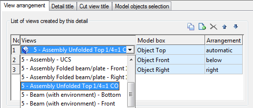

The views created by a selected drawing style are listed in a table.
For each view, a predefined model box and arrangement may be selected. View properties are displayed by double-clicking a view in the table. For more information, refer to
View Properties.
The toolbar contains all the necessary management functions:
| Button
Function
Create a new view
Add an existing view

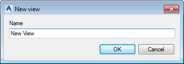

Create a new view
A new view is created by copying a view from the list.
- Select a view from the list.
- On the properties panel, click
(Create a new view).

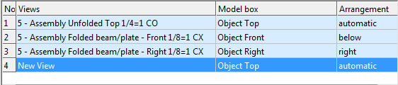

- Enter a name for the new view:
The new view appears in the tree and in the list.
- You can assign a model box and a view arrangement to the new view. This does not affect the original view.
