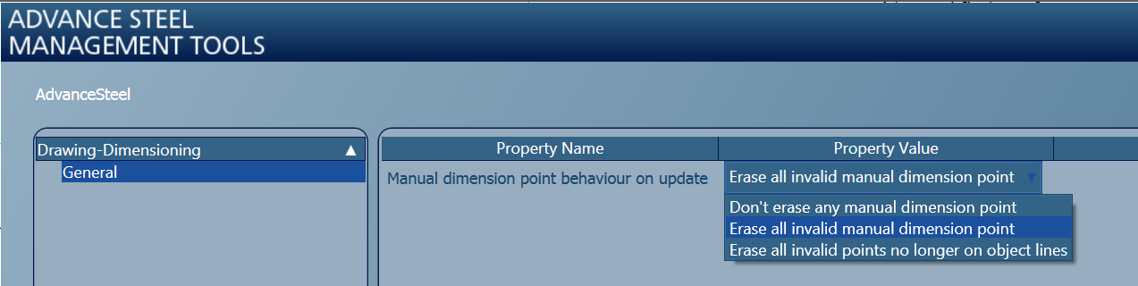

Learn about the different options of the Manual dimension point behavior on update default.
The three settings available for this default will control the behavior of manual dimensions during update.
By default it is set on Erase all invalid dimension point - This setting is best used if all the dimensions are created matching the requirements of smart dimensions. This setting will ensure that all the dimensions are created between valid points, that can update, and that during update, the dimensions values are correct and according to the model.
The drawback of this setting is that it doesn't allow dimensioning of any invalid points, on a reference object or in mid-air (to for example a virtual reference).
Don't erase any manual dimension point - This option will disable the deletion during update of any invalid points, but the smart dimension points are still recognized and updated as required. The major advantage of this option is that you can dimension anything, and if the geometry doesn't change during update, you will still have a good dimension. The disadvantage is that the invalid points will not move. If the geometric change is small (hard to spot a difference during update), there is a risk that the dimension which didn't move during update will no longer be correct, giving a false value. High awareness is required when using this option, to avoid introducing errors in the drawings
