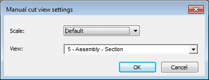

| Scale | This combo box contains all the scales available in Advance Steel and one default scale. The default scale is an intelligent setting that uses the scale of the view selected for the manual cut view. Using the default scale allows you to create manual cut views (that use the scale of the main view) faster, without the need to manually match them afterwards. The Scale field is set to Default. Once you change the scale from this dialog, the change is saved and can be reused for other manual cuts created afterwards until the dialog is accessed and the scale is changed again. Advance Steel memorizes the last used scale until you close the software, defaulting back to the Default value when you reopen Advance Steel. |
| View | This combo box contains a list of all the view requests available in Advance Steel - that are used when generating manual cut views. |

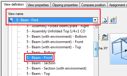

The view requests provide all the settings required for creating the cut view (object presentation, labeling rules, line type, and dimensions). The view requests are located in the Drawing style manager, for each drawing style. You can use the Drawing style manager to make edits to preferred cut views requests, if needed.
You can find the list of view requests available for manual cuts in the Drawing style manager, at the following level:
In the Manual cut view settings dialog, in the View combo box you can choose between the Advance and User view categories:
By default, Advance Steel sets the view request from a series of defaults found in the Management Tools application. Once you select a view request from the list, it is saved in the local memory and reused for the manual cut view command until you exit Advance Steel, similarly to the scale setting.
