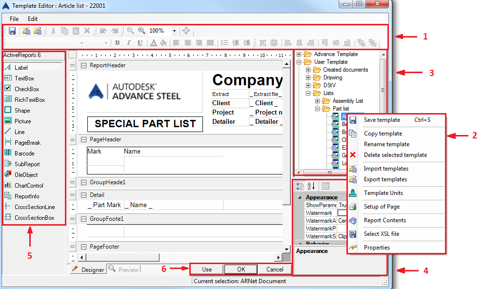

Learn about the options available in the BOM editor.
Access the command
In the Output tab
Document Manager panel, click
(BOM Editor).
Command line: _Astm4CommBomEditorEx
The BOM editor window opens.
Template designer Template preview |
Tools for template customization

Tools for template management
Different tools for template management are available in the context menu of a selected template.

Template tree
The predefined templates for material reports are displayed in the right panel of the BOM Editor window. The tree is divided in three groups of templates.

Properties list
Displays the current settings for properties of the selected object in the Design area. You can modify any property that can be changed by specifying a new value.
The properties are grouped in several categories:

Buttons for applying or canceling the modifications
| Button | Function |
