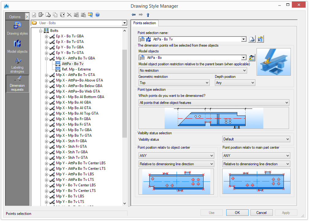

A dimension point selection rule contains settings for model objects and geometric restriction, point type, position on object or on main part.
The Points selection rules can be shared by different dimension strategies. Consequently, modifications affect all the dimension strategies that use the modified points selection rule.
Select a predefined point selection rule from the list. The existing rules can be renamed and new rules can be added.
| Button | Function |
Define a new point selection rule. A copy of the current settings is created and a new item appears in the drop-down list. |
Rename a point selection rule. The current settings are saved under a different name. |
Select the properties of the objects geometry used in the points selection process (e.g. objects contour, object features, holes etc) in the Point type selection area. Furthermore, points can be used as reference.

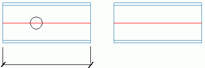

Example:
A dimension line if there is a hole, and if there is no hole in the main part, no dimension chain is created.
| Points selection rule | Result |
Holes - All features Main Part - Extreme as reference |

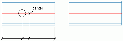

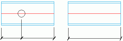

Examples:
Holes - All Beam - Extreme as reference |
Beam - Extreme Holes - Beam |
Holes - All Beam - Extreme as reference Center points as reference |

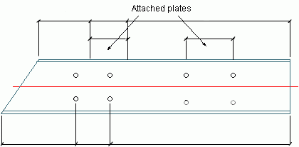

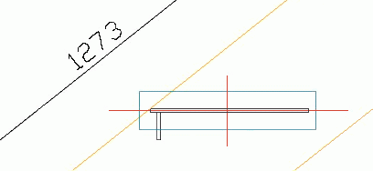

Example: The steps of a stair:
Examples: Point position on object and on main part.

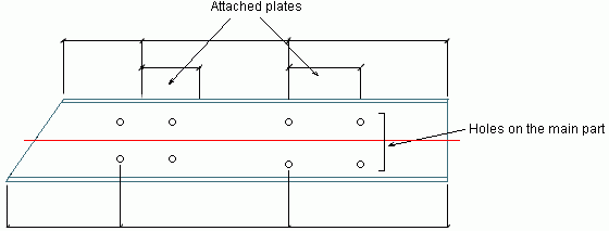

Use the Left restriction relative to the object for the attached plates and the holes.
Both attached plates and all groups of holes from the main part are dimensioned as shown in the following image:
Only the attached plate and the holes placed in the left side of the main part are dimensioned as shown in the following image:
