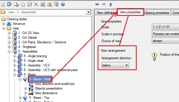

The arrangement of views on shop drawings is dependent on a set of rules in the drawing style and further influenced by a default value set in the Management Tools application.
The view arrangement strategies are located in the View properties tab, of the view definition:
Defining a distance between views (always measured from the extreme object of the detail view) avoids overlapping of individual views on the drawing.

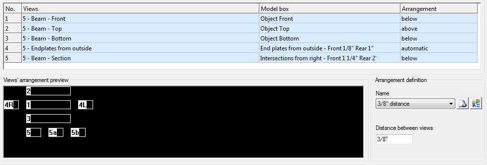

There are two types of view arrangement strategies available in the Drawing Style Manager:
Each view is positioned in relative position to the main view. The options here include below, left and right that are all relative positions to the main view in the paper space.
For example, in a beam drawing style, the top view can be arranged at the top, but when considering the same beam drawing style for a column with a vertical layout, the same top view will be placed to the left of the main view arranged on the left setting. The schematic preview below the view list determines where each view will be placed in relative position to the main view:

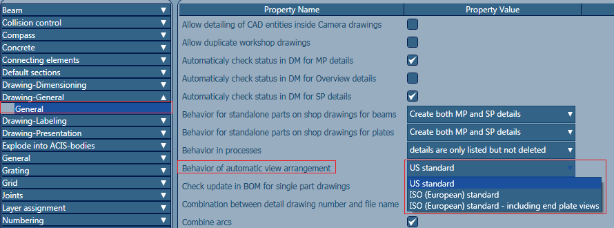

This is configured by setting all the views on an automatic arrangement. The automatic layout of the views is done based on the third or first angle rules. The method used here is set by a global default value available in the Management Tools application
Defaults category
Drawing-General:
ISO (European) standard includes end plate views using the same method to arrange the views: first angle projection. It does also switch the position of the end plate views with the left hand side end of the beam end plate view placed on the right side of the main view.
