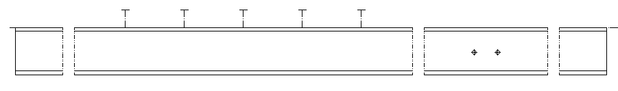

| Selection set | Only the selected elements are detailed. |
| Single part | Only the single parts are detailed. |

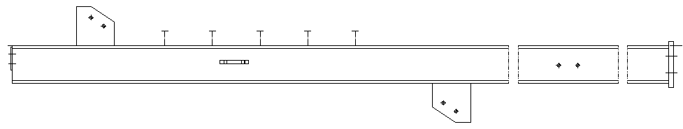

| Main part | Only the main parts are detailed. |

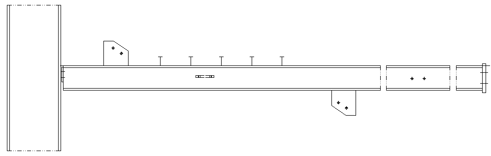

| Main part with environment | Main part with attaching parts and defined environment. In the model box, a XY- and a Z-viewport must be defined. |
| Main part and additional elements | The main part and additional Advance- and ACIS-solids. |
