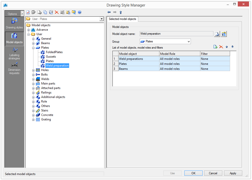

Model objects act as filters for objects from the 3D model. A model object is defined by the object type (e.g. Beam), model role (e.g. Column) and an additional filter (e.g. with holes).
The list of model objects, roles and filters can be modified. New strategies can be added or existing strategies can be renamed.
| Button | Function |
Define a new model object. A copy of the current settings is created. It can be moved to another group using the Group drop-down list. A new item appears in the tree panel under the specified group. |
Rename the model object. The current settings are saved under a different name. |
The toolbar contains all the necessary management functions:
| Button | Function |
Add a model object. |
Delete the selected model object. |
Move the selected model object up the list. |
Move the selected model object down the list. |
