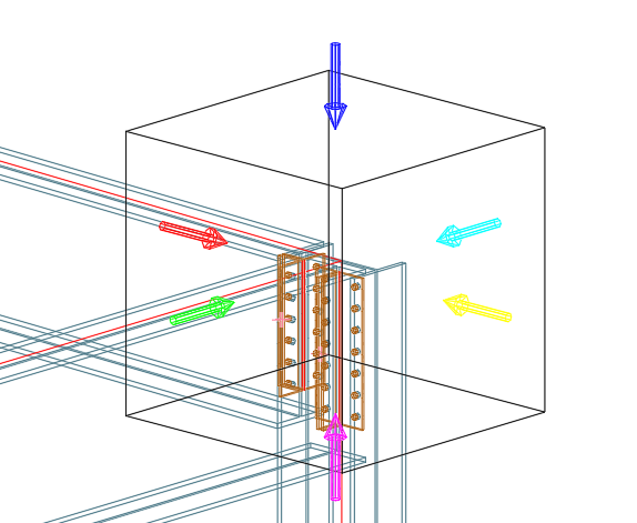

A difference between how cameras set the view box - how much of the model it details, and how the model view isolates certain portions of the model, consists in how the clipping planes of the box act.
For model views the clipping planes are fully independent, and each one can be individually activated or deactivated. The camera detailing view box is more restrictive, with the x0y view box being either automatic or limited. To keep consistency between the two, the model view clipping planes behavior was modified for when the model view has the camera functionality active.
When the camera detailing functionality is disabled for model views, the six clipping planes from the Model view dialog
Clipping tab, work independently from one another, controlling the 3D model isolation capabilities for the model view.
When the camera detailing functionality is enabled, the active and inactive state of clipping planes in the Model view dialog
Clipping tab, change to match the detailing necessities:
Together with the clipping planes, the view box definition is also controlled by the box itself. Using a fixed view box, with checked clipping planes triggers the model view camera detailing to use the model view box as a reference. Changing the box size in the model will trigger an update of the camera view box, allowing you to add objects to the camera detail or remove objects from the camera detail.
The detailing direction for the model view as a camera object is defined when you create the model view and it is the same direction as the one chosen to define the model view viewing direction.
You can change the viewing direction for an existing model view and trigger an update to change the detail view direction, by using the model view as a camera - select the model view box, right-click and select Change default view direction from the contextual menu. In addition to controlling the view direction of the model view - used for both 3D modeling and camera detailing purposes, the model view right-click contextual menu also has the Show Camera Graphics option that changes the display type of the camera, showing the detailing plane and direction, similarly to the camera symbol.
