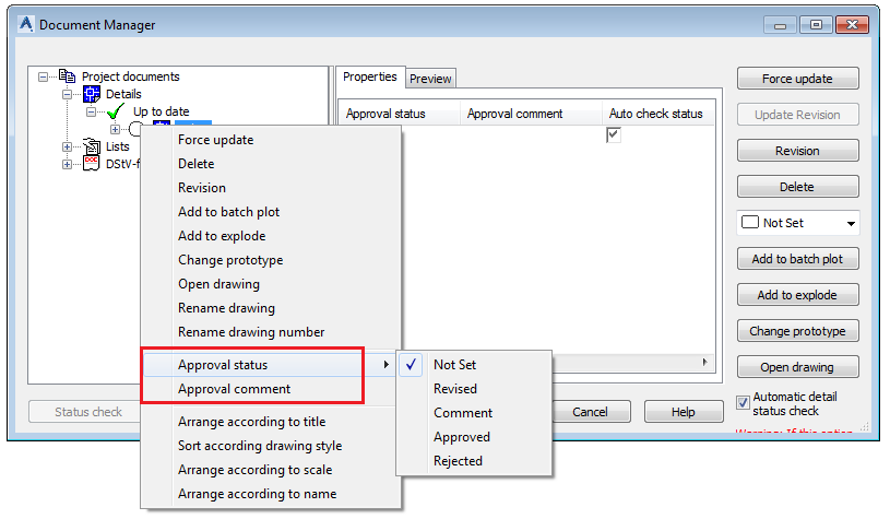

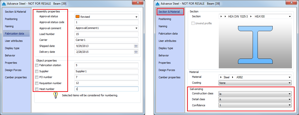

Include fabrication data in BOM templates and prototype headers.
Object fabrication data parameters can be included in:
In prototype headers.
| APPROVAL_STATUS_ASSEMBLY | Approval Status |
| APPROVAL_STATUS_CODE_ASSEMBLY | Approval Status Code |
| APPROVAL_COMMENT_ASSEMBLY | Approval Comment |
| CARRIER | Carrier |
| LOAD_NUMBER | Load Number |
| SHIPPED_DATE | Shipped Date |
| DELIVERY_DATE | Delivery Date |
| GALVANIZING_CONSTRUCTION_CLASS | Construction Class |
| GALVANIZING_DETAIL_CLASS | Detail Class |
| GALVANIZING_CONFIDENCE | Confidence |
| FABRICATION_STATION | Fabrication Station |
| SUPPLIER | Supplier |
| PONUMBER | Po Number |
| REQUISITION_NUMBER | Req Number |
| HEAT_NUMBER | Heat Number |
