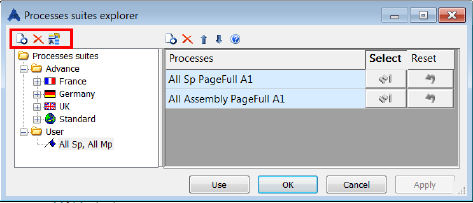

Using the buttons on the top-left of the Process suites explorer dialog box, you can rename the existing (process) suite, copy a process suite or create a new one.

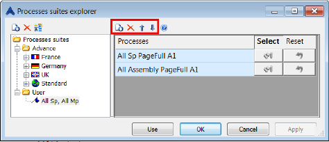

Once you select a process suite, there are several options available to modify the process list (insert, delete and change the order by moving up and down).

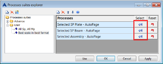

For each process, you need to select the objects from your model for this process.
To select the objects:
Notice that once your selection is done, one of the objects in the blue icon will be colored in yellow.
Your process will run in the defined order, and the workshop drawings will be automatically created.
