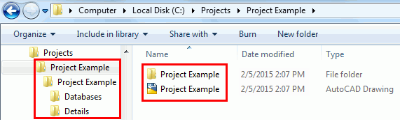

It is recommended to create a folder with the same name as the model .dwg file in the desired location on your drive and save the model drawing in the folder and with the same name. As the project becomes more complex and derived documents are created, Advance Steel creates a sub-folder in the master .dwg file location, with the same name as the .dwg file. In this folder, sub-folders are created automatically as required for details (drawings), BOMs, calculations, NC files, etc.
Example:
