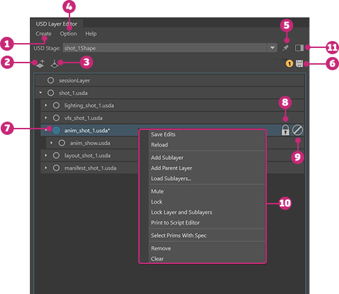

USD Layer Editor Interface
# Option Description
1 Create a stage Select from this menu to create a new USD stage or create a stage from an existing USD file.
2 Add a new layer Click to add a new anonymous layer next to the selected layer. If no layer is selected, the new layer will be added as the topmost sublayer under the root layer.
3 Load an existing layer Click to load an existing layer as a sublayer to the selected layer or the root layer if no layer is selected.
4 Options menu Select Options > Auto-Hide Session Layer to automatically hide the session layer.
5 Pin a stage Click to pin a stage. When pinned, the stage selection in the USD Layer Editor will be maintained regardless of the selection made in the Outliner. When unpinned, the stage selection in the USD Layer Editor will automatically update to reflect the stage or prim currently selected in the Outliner. Tip: Setting a pin will trigger a scene save. Also, your pin state and selected stage will be remembered between Maya sessions.
6 Save a stage Click to save a stage and bulk save any unsaved edits on your stage. The number of unsaved edits is displayed beside the save stage icon.
7 Set target layer Hover next to a layer name and click the grey target icon when it appears. Once a layer is set as the target layer, the highlighted target icon appears next to the layer name. Once a layer is set as the target layer, any scene editing operations are made on this layer.
8 Lock a Layer Click to lock a layer. When a layer is locked, you cannot target or add sublayers to it. If a locked layer has sublayers, they cannot have new parent layers added to them.
9 Mute a Layer Click to mute a layer. When a layer is muted, it is ignored by the stage and the contents of the muted layer disappear in the Viewport and Outliner. Muted layers do not participate in value resolution or composition. Muting can be used if a particular layer is affecting performance or having an undesirable effect on the scene.
10 Context menu Access the context menu by right-clicking a layer.
11 Layer Data Window Click to display the contents of the currently selected layer in detail.

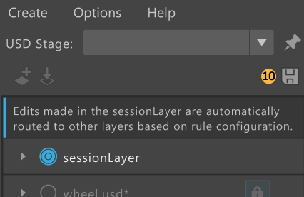

Edit Forwarding Preview
If there are Edit Forwarding rules on a stage a banner will appear in the Layer Editor telling you edits made in the Session Layer are automatically forwarded based on the rule configuration.
