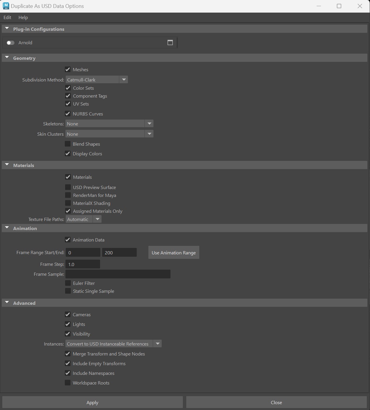

- You can customize the Duplicate as USD Data settins by right-clicking on the prim and selecting Duplicate as USD Data > Options. In the Duplicate As USD Data Options window, you can specify what data you want to include for the duplication.
- You can also access the Marking Menu in the Viewport with a selected Maya node to activate the option to Duplicate as USD Data.
To duplicate Maya data as USD data:
- Select a Maya node (when a USD stage is present in the scene) > right-click > Duplicate as USD Data
- If multiple stages are present in the scene, you can select which one to duplicate the data into from the stages presented.
- Select Options... to choose the way your Maya objects are exported to USD. The Duplicate as USD Data window appears with the same options as the typical export options; including Geometry, Materials, Animation and Advanced settings. In this window you can set your preferences for the export. After building out the scope of your options, select Apply to apply your settings or Close to cancel the operation.
Important: When you duplicate edits to USD, the options in this dialog that you select can persist in Maya memory from the last time you exported and even in your last Maya session. Ensure you check these settings each time as your selections can be saved in Maya. You can also select Edit from the top left menu in this dialog to Save Settings or Reset Settings for any Maya data export processes.
