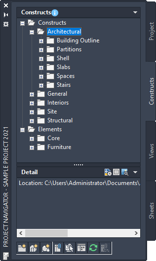

Your Constructs tab might look like this:
