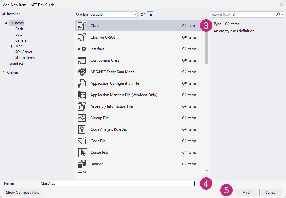

  1. In Microsoft Visual Studio, Solution Explorer, right-click the project to which you want to add a new item and click Add New Item.
  2. In the Add New Item dialog box, click Show All Templates.
  3. In the Add New Item - <project> dialog box, select the template that represents the item you want to add.
    • Code File - Represents a code module
    • Window (WPF) - Represents a WPF window (or dialog box)
    • Form (Windows Forms) - Represents a Windows form (or dialog box)
    • Class - Represents a class module
  4. In the Name text box, select the default name and enter a new name for the item.
  5. Click Add.
