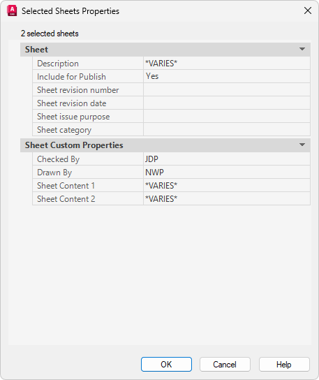

Selected Sheets Properties Dialog Box
Displays properties that are common to and can be edited for the selected sheets, such as description, include for publish, sheet revision number, and even custom properties.
SHEETSET (Command) Find: Select multiple sheets in a sheet set > Right-click the selected sheets > Selected Sheets Properties
Summary
You can enter a new value to modify any available sheet property.
List of Options
The following options are displayed.
Sheet and Sheet Custom Properties
Displays the properties of the selected sheets. Also displays custom properties, if any. You can enter a new value to modify any sheet property.
