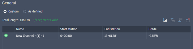

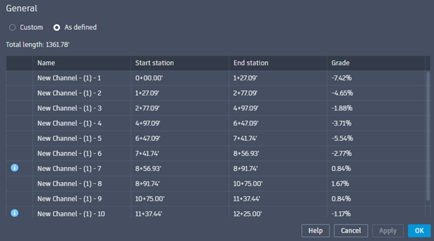

General
Custom. Enables the option to edit the segments of the channel in order to define the start and end stations of each gradient segment.
As Defined. Enables the automatic creation of channel segments based on changes in gradient along the baseline.
Total Length. Displays the total linear length of the baseline.
Name. Displays the name of each channel segment. This adds a numerical suffix to the channel name and is read-only.
Start Station. Displays the start station of each channel segment. This value should be within the defined station range or an error will be displayed.
End Station. Displays the end station of each channel segment. This value should be within the defined station range or an error will be displayed.
Grade. Displays the gradient of each channel segment. This is represented as a percent gradient and will read Horizontal if no slope exists. A negative gradient represents a downward slope along the stationing.
Custom Option Tools. The following tools are available when using the Custom option.
  • Import from automatically calculated slopes. This will overwrite any customised slope data with auto-calculated data. The user will then be able to adjust the auto-calculated data.
  • Insert row above. This option splits the station range for the current row and adds a row above. A station value must be entered to define the location of the split.
  • Insert row below. This option splits the station range for the current row and adds a row below. A station value must be entered to define the location of the split.
  • Delete selected row. This will delete the current station range by combining it with the row below. If the last row is deleted, it is combined with the row above. If there is only one row, it cannot be deleted.
Note: Channels that change slope direction (i.e. pass through a crest or sag point) should not be modelled as a single channel element. When slope direction reverses within one channel, flow may not correctly reach the intended downstream outlet during simulation and can be lost from the system. Best practice is to split the channel at each crest or sag and define the resulting segments as separate channels. A null structure should be placed at sag points, where flow from opposing slopes converge.
