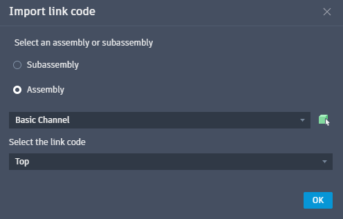

  • Import Points from Link Codes. Imports points from a specified assembly or subassembly in the drawing. In the resulting Import link code dialog box, first select the option between subassembly or assembly, then select from the dropdown list, or click to manually choose a subassembly or assembly from the drawing. Once selected, specify a link code from the drop-down.
