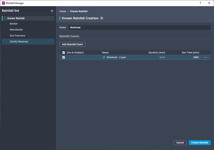

  1. In the Analysis Criteria workspace, click Open Rainfall Manager.
  2. In the Rainfall Manager, click the Known Rainfall tile.
    The Known Rainfall Creation editor opens.
  3. In the Name field, enter a unique name for the rainfall set.
Note: At least one rainfall event must be entered before the rainfall set can be saved.

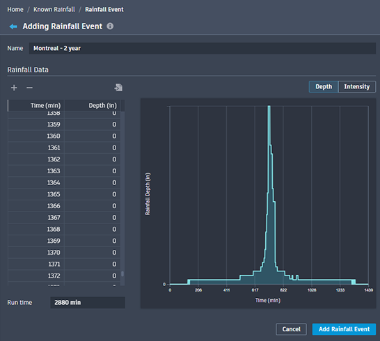

  1. In the Known Rainfall Creation workspace, click Add Rainfall Event to begin creating events for the rainfall set. The Adding Rainfall Event editor displays.
  2. In the Name field, enter a unique name for the rainfall event.

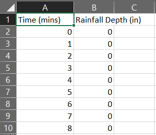

  3. Click import rain data to import a csv file containing rainfall data.
    Note: The data format of the rainfall CSV file must adhere to the following:
    • Two columns of data are required. Multiple columns are possible, but only first two are considered.
    • The first row is considered as header data.
    • The data is limited to 2-25,000 rows of numeric data.
    • Only numerical data is allowed for rainfall data rows. Empty cells, strings, alphanumeric signs, and other characters are considered invalid.
  4. The data is then presented in a table and a hyetograph.
    The table and hyetograph can display either Depth or Intensity data. Data displays using the units defined in the source drawing.
    Note: There must be at least two entries containing the minute increment and its coinciding rain depth in inches (or millimetres depending on drawing units).
  5. Click Add Rainfall Event to add the event to the Known Rainfall set. The Known Rainfall Creation editor displays showing the updated Rainfall Events List.
  6. Click Create Rainfall to save the Known Rainfall set. The Rainfall List displays the new Known Rainfall set.
