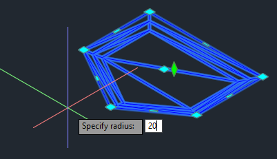

To Add Curves to Pond Geometry
Add curves to pond geometry for a smoother and more natural appearance. Curves adjust how segments join at the vertices of the pond.
There are two methods to add curves to a pond.
Add Curves to the Whole Pond
    This method applies a curve to every vertex in the pond.
  1. Select the pond.
  2. Click the Pond tab Edit Geometry panel Fillet Pond .
  3. Type a curve radius value and press Enter.
    The curve radius is applied to each pond vertex.
Add Curves to a Single Vertex
    This method allows individual curve specification for each vertex in the pond.
  1. Select the pond
  2. Place the cursor over the vertex grip and pause for the contextual menu.
  3. Select Add Curve.
  4. Type a curve radius and press Enter.
    The curve radius is applied to the selected pond vertex.
